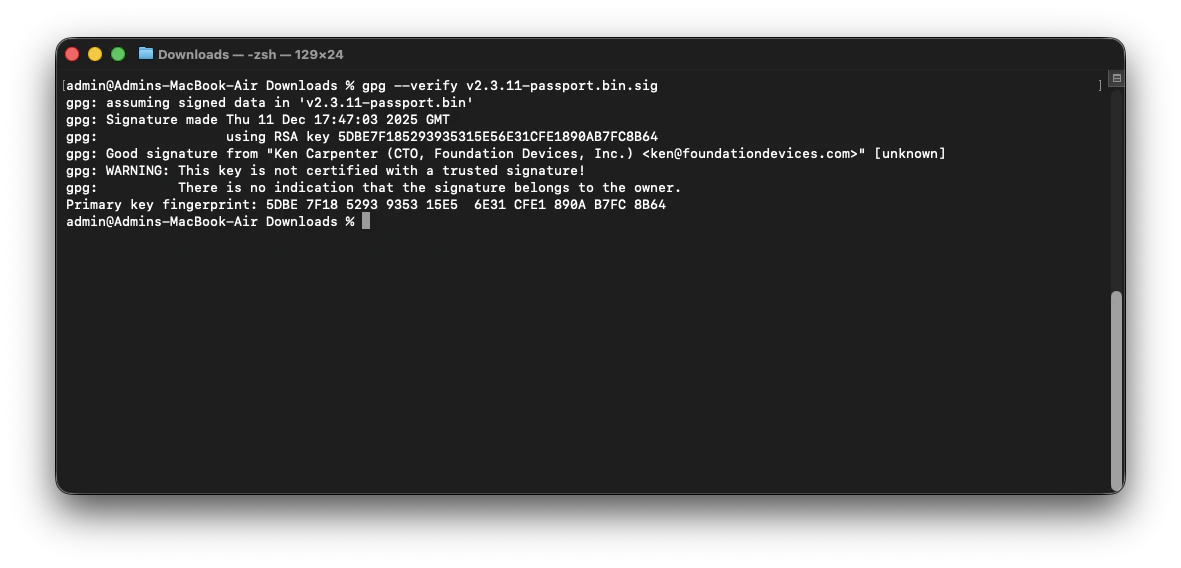

To verify the firmware available for download is published by a legitimate source, from v1.0.8 we now sign all firmware releases for users to verify. The public key producing this signature can be imported from our website , GitHub or downloaded directly below.
Once downloaded, the key can be imported using gpg --import foundation_key.pgp.
The key ID should be CFE1890AB7FC8B64 and the fingerprint is 5DBE 7F18 5293 9353 15E5 6E31 CFE1 890A B7FC 8B64.
Next, download the signature file published with the firmware release on GitHub to the same folder as the firmware file. The signature file will be appended with .sig.
Open the folder containing the two files in a terminal window and run:-
gpg --verify v2.3.11-passport.bin.sig
The above command is an example and should be amended to suit the firmware version being verified.
For this step to be considered successful, look for the term Good Signature. This means that provided signature was produced by the person in control of the published signing key that can be found on this page, our website and our GitHub.
WARNING: This key is not certified with a trusted signature means that PGP doesn't place a high level of trust in the key downloaded from the internet. For this to be a fully trusted key, it would need to be verified in person. Due to practicalities, most people do not do this and instead look to verify a key from multiple different online sources.

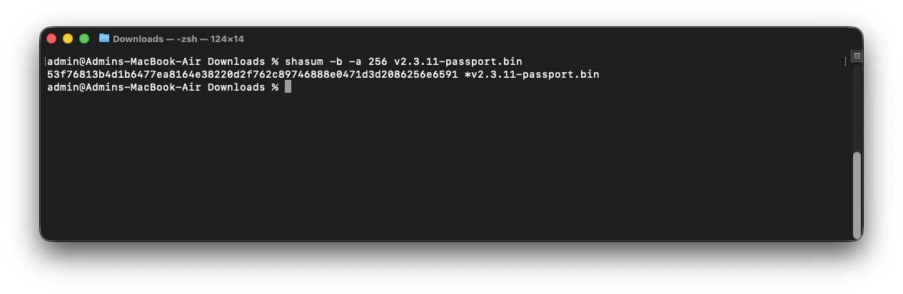

Advanced users can verify the integrity of the firmware contents prior to installing onto the device by using the sha256 function in the terminal of their computer. The resulting hash can then be compared with the one published by our developer team on GitHub.
Download the firmware and run shasum -b -a 256 v2.3.11-passport.bin, ensuring that the firmware version is amended to the file being checked.

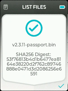

Firmware Contents Verification - Passport
This file integrity check can also be achieved on Passport. Download the firmware onto a microSD card, insert this into the device and then go to:-
Settings > Advanced > MicroSD > List Files > Then press select on the .bin file.
The resulting hash can then be compared with the one published by our developer team on our GitHub .
